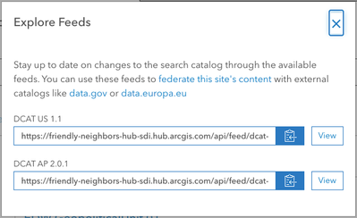

Jill_Saligoe-Simmel
Hi, just a minor update. When visiting your Hub catalog page, you can now view the "Explore Feeds" button on the left side of the page without needing to remember the URL parameter 🙂
