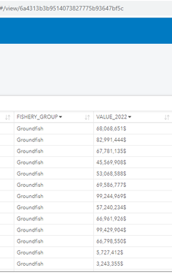

Without changing browser language settings, in published report how to display French style numbers that use space and not comma
3154
5
11-24-2023 12:44 PM
Ming
by

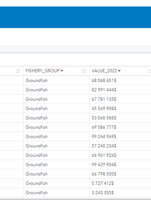

You can add a $ sign behind a number in Insights Enterprise or Desktop v2023.2, but you cannot configure the number display to be in the French manner, where a space is used in place of a comma. When using Insights desktop, you can alter the language settings to see a space instead of a comma. However, once published, if the browser language setting is still set to English, the comma will once again appear.
Desktop:
Browser:

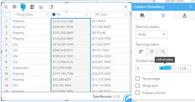

AkshayHarshe
@Ming  I didn't realize that you are using a numeric field in the Reference table card and adding a dollar sign for representation.
you can configure where to place the dollar sign by selecting the field on the reference table card and going to the column formatting:
If you use a numeric field, the substitute formula I sent will not work as the comma is just a representation in certain languages. I do understand it could be an enhancement to let users choose a separator of their choice, but I am not sure if we can justify that as the whole point of i18N language support is to automatically handle these cases according to the browser language.

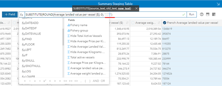

AkshayHarshe
If you absolutely must, Then I would suggest you create a new calculated field with `CONCAT("$", <Field> ) ` or `SUBSTITUTE(<Field>, ","," ")`

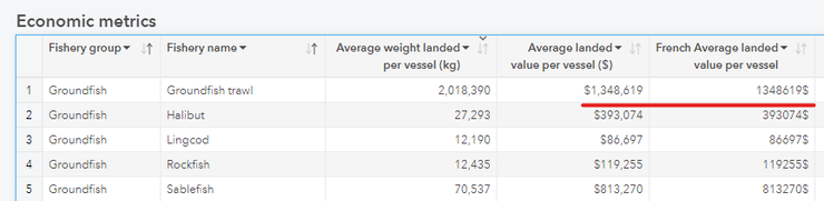

Ming
by
Thank you very much @AkshayHarshe for the response.
In the Substitute function I used space " " to replace the comma ",", in the result the comma is gone but there is no space. Maybe it works for string, but for the field calculation functions, there is no function to convert number to string.

AkshayHarshe
