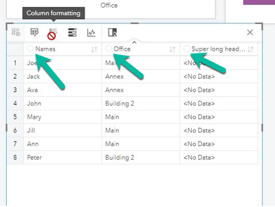

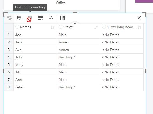

I'm using Insights in ArcGIS Online (v2022) and I can't format columns in a reference table. As you can see the column formatting option is not available.
Is there a setting I need to turn on?

@AliciaShyu,
If you select one of the fields first, you should be given the option to format.
Scott

@AliciaShyu,
This is a bug we're working to fix. Developer has identified it and proposed a fix so this should be addressed in an upcoming release.

AliciaShyu
Thanks for the quick reply. I noticed the wrap text does not include the header. Is there an option somewhere else to wrap the header text?

Ian_Muehlenhaus
I do not believe so, but I may be wrong. Others may correct me. This is a potential feature enhancement.
