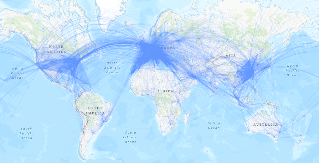

I know in Insights Desktop a user can create a `flight path map` similar to the one shown below. In regard to this, I have the following questions:
  1. Can someone share a workflow/tutorial on how to create one?
  2. Do I need a shapefile or a CSV can also be used? In either case do I need to have a coordinate column or a centroid coordinate for the origin and destination polygon? Do the coordinates need to be in WGS84 format or it can be any CRS supported by ArcPro?
  3. Can I change the boldness or color of the path depending on the number of outflows from the origin point to each destination point?
Desired output:

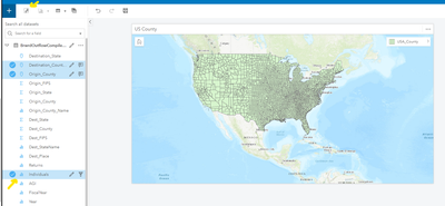

@Ian_Muehlenhaus In step 4 under Link Map, there's a calculation of total population which in my case is called `Individuals`. Then in step 6 when I select `Destination County`, `Origin County` and `Individuals (for some reason the column `Total Population` used in the tutorial has a different type than that of `Individuals`), Insights does not give me the map option.
How can I fix this?

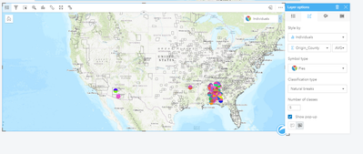

@Ian_Muehlenhaus I got the map to plot by selecting the columns shown above however, I am not getting the `link map` instead it's a pie chart map as shown below.
How can I fix this?
Question | Analyze | Visualize
Ian_Muehlenhaus
Esri Contributor
A-ha! This is happening, because these are String/Text data. Chart maps are created for string data. Link maps with numeric data.

@Ian_Muehlenhaus,  for enabling location I am using the `US Census 2020` data from the Living Atlas. In this dataset, the data of interest is US County which has multiple columns as shown below:
So when the enabling location process completes, it links the `Origin_County` column in my dataset to the first column, `County FIPS`. Thus in the link map popup for the bubble, County FIPS numeric value shows up instead of County Name. And, the Enable location pane does not let me select the column, `County Name`, from the `US County` dataset. Plus, you know Insights allow delete columns either otherwise I would have deleted all other columns except Column Names.
How can I fix this?
Ed_
by MVP Regular Contributor
Never mind, I figured it out, just had to use `USA Counties` dataset from the living atlas. However, it would be cool to have the ability to select the column from the `Geography` dataset, so that the process does not default to the first column.
