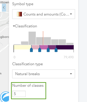

Ah yes, so the trick to that is to change the number of classes before you switch the classification type to manual.
So if you switch back to say natural breaks, then adjust the Number of classes, then switch to manual, you will have the right number of classes. This is something we have identified in our backlog to improve.
Hope this works for now!

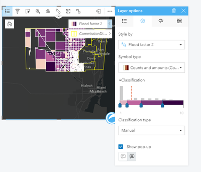

KateMaclachlan
Hi Saadullah,
So in your screen shot above you're almost there! after switching to manual classification you should be able to click on the blue class separators and a text box should come up in which you can adjust the variables.
Hopefully this helps!
Thanks,
Kate

Cheers @KateMaclachlan , but how can I add more blue ticks (classes) while performing a manual classification?

KateMaclachlan
