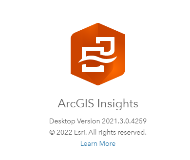

Are you still experiencing this issue?  What version are you using?

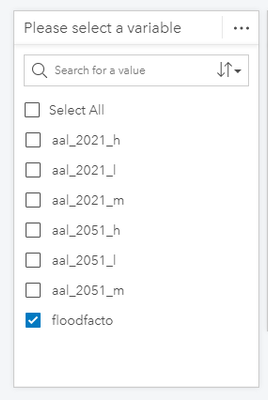

I will add though if Insights supported multiple column/variable selection in a single drop down menu, that would drastically reduce the data size. Because right now, in order to have such a selection, I have to pivot long the dataset which increases the number of rows by multiple folds thus increasing the data size.
