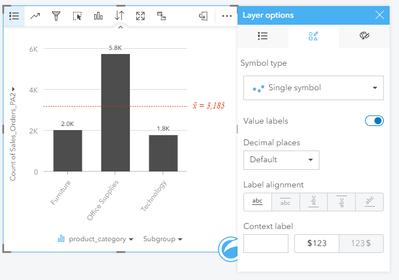

AkshayHarshe
@LeonKincy Labels are available on Single category Bar, column, and line charts.

LeonKincy
This looks like what I want, but when I click on layer options, I can access appearance, but not symbology.
AkshayHarshe
I think you have a 2 categorical fields on the bar chart. I only works when on Bar, column and line charts with one category. E.g Gender/ sum of population. If you have a unique value renderer on the bar chart then try and remove that.
