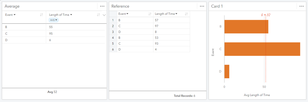

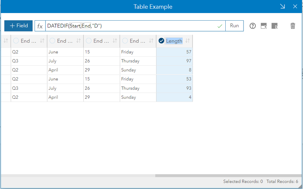

If you click on the the three dots next to your data source name and open up the data table you can calculate a new field that shows the length of time between two dates.
The calculation you would use is DATEDIF(start_date, end_date, [unit]). The Unit is the unit of measurement you want to calculate:
  • "ss" = seconds
  • "mm" = minutes
  • "h" = hours
  • "D" = days
  • "M" = months
  • "Y" = years
Once this new field has been calculated, you can use it like any other numeric field in Insights to display the average length of time.
