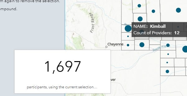

Is there a way to dynamically label the KPI widgets?
In this project, it would be nice to have a county name label show up on the KPI, similar to functionality in a dashboard KPI.
This image shows the total count, and the popup for the county that is picked in the second image.
I'd like to be able to add "Kimball County" as a label in the KPI dynamically, so it would change as users click around and make additional selections.

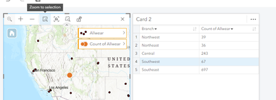

AkshayHarshe
Sorry, I missed your follow-up comment. You can choose to use "Zoom tools" and Zoom to select after selecting the table.
If you wish to do this dynamically, turn on the Cross filters on the map card.
