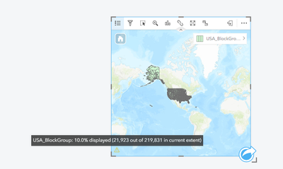

Hi @Ed_ ,
I am wondering what issues you are facing or if is it blocking you in any way.
It depends on a combination of factors like scale, extent, feature layer limitations, etc. The map card should show a warning sign if the features are not displayed. Clicking on the warning sign should show you how many features are displayed to the current extent.
Let me know.
