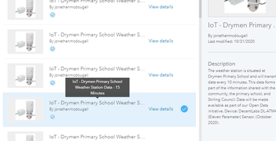

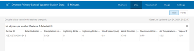

Hi, thanks for the reply. I've got a support ticket open for other Insight issues, however, for sanity's sake, I'll post a couple of grabs for you. And just to be clear, my issue is when using a view layer of a dataset created in AGOL, then using that view within Insights.
My AGOL feature service view - returning the 1 record from the last 15 mins.
If I take this view layer into Insights -
I get -
Insights ignores the view and goes back to "mumma"
