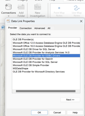

jakubk
I've gotten it working. got the idea from here - https://gis.stackexchange.com/questions/438176/wkb-to-feature-class-in-arcgis-pro
you need to get the simba odbc driver and use the OleDb connection in Arc Pro
And select OleDb for ODBC
Type in your odbc connection string for databricks and off you go
