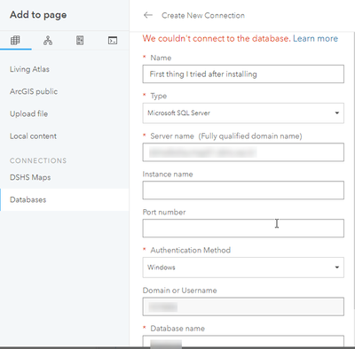

Just an idea.  I'm evaluating ArcGIS Insights Desktop 2022.2.0.4957 to add to our barrel of BI products.  I installed it on my workhorse PC, Windows 10 Enterprise 21H2.  I tried to connect to my solid, fully functional 10.9.1.2.9 enterprise geodatabase in SQL Server 2019 Enterprise.  ArcGIS Insights Desktop didn't even get past the first thing I would wanted to do.  SQL Server Management Studio, Power BI Desktop, Tableau, ArcGIS Pro, ArcGIS Enterprise, ArcMap, QGIS, Excel, etc. can do it, no problem.
My idea is that ArcGIS Insights could do it, too.  Fastest software evaluation I've ever done.

1. The authentication method: according to your screenshot, I believe you are using Windows authentication to connect to your SQL Server database. If this is right, please check the next point.
2. There are required privileges for SQL Server database users that can make the connections from Insights to the SQL Server database. Please check the help doc at Required database privileges—ArcGIS Insights | Documentation.

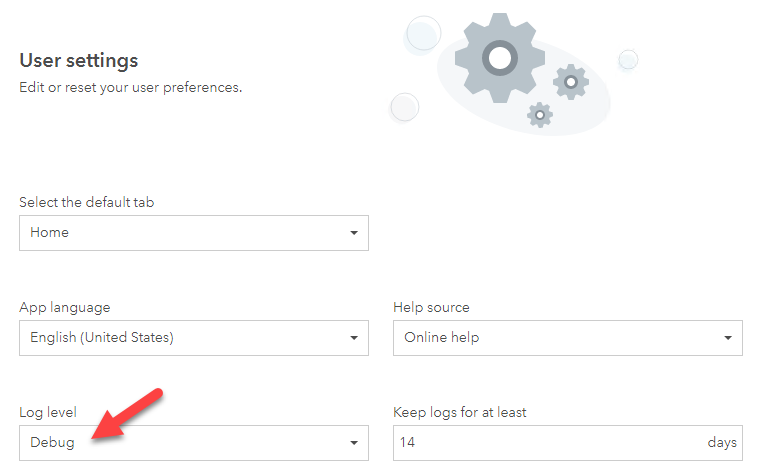

3. The logs in insights_service.log can help us troubleshoot the issue. For Windows system, it is located at C:\Users\<username>\AppData\Roaming\Esri\ArcGIS Insights\logs. Repeat the issue and check the last few records there. Please send us the records. Note, before you start checking the log, make sure that set the log level to Debug from the Insights Desktop settings.
We will check the logs and determine the root cause.

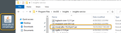

The SQL Server driver delivered with Insights Desktop 2022.2 is mssql-jdbc-9.4.1.jre11.jar. Let's try the newer driver mssql-jdbc-10.2.0.jre11.jar (https://github.com/microsoft/mssql-jdbc/releases/download/v10.2.0/mssql-jdbc-10.2.0.jre11.jar).
The SQL Server driver is under C:\Program Files\ArcGIS\Insights\insights-service if you are using default path in installation. Remove the old SQL Server drvier mssql-jdbc-9.4.1.jre11.jar and copy the new driver mssql-jdbc-10.2.0.jre11.jar there. You need to close the Insights Desktop app before replacing the driver.
Start the Insights Desktop after the new driver is in place. Try to create the SQL Server database connection again. Let me know if this works.

I found the reason of why newer JDBC driver doesn't work. We forget updating the mssql-jdbc_auth DLL when we updated the jdbc driver. The version of JDBC driver and the jdbc_auth DLL must be the same version.
Please try the mssql-jdbc-10.2.0.jre11.jar and mssql-jdbc_auth-10.2.0.x64.dll (https://search.maven.org/artifact/com.microsoft.sqlserver/mssql-jdbc_auth/10.2.0.x64/dll) first.
Put mssql-jdbc-10.2.0.jre11.jar to "ArcGIS\Insights\insights-service", and mssql-jdbc_auth-10.2.0.x64.dll to "ArcGIS\Insights\resources". Make sure remove the old jar and old dll files.
If you want to use the latest driver v11.2.1, you need to get the same version of the dll file.
Let me know if the problem is solve.
