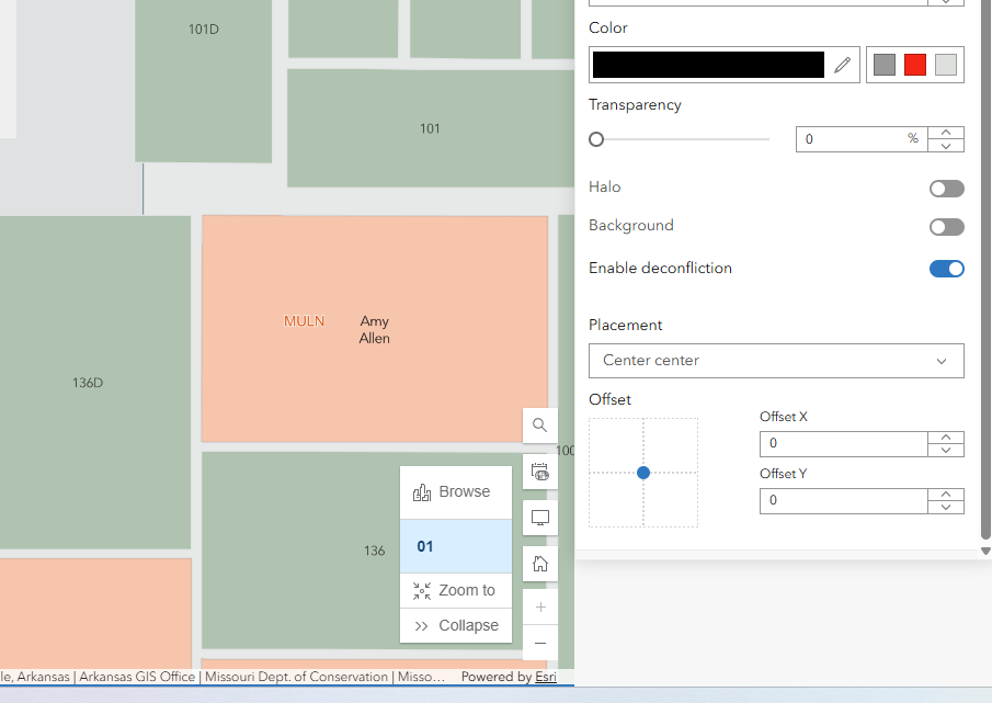

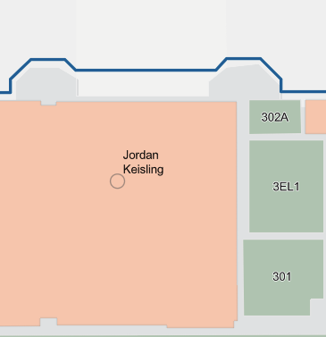

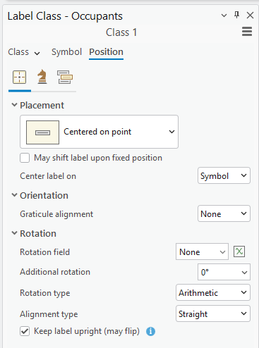

I am very new to Indoors but as my title suggested, the Space Planner app doesn't seem to honor the label rules of my underlying web map. I've configured the label for my Occupants layer from both the feature level as well as in AGOL map viewer but it somehow always reverts to the Upper Right position.
