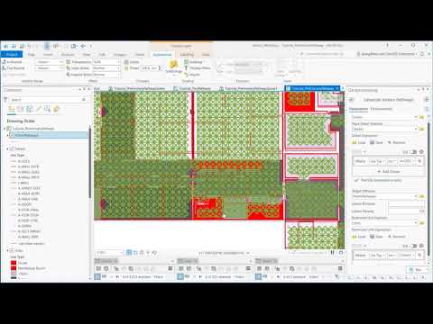

I find the same problem on Esri Training video. I left a message there to ask for solution also. I think changing lattice density may help but we try making the figure to 0.35. We still find some rooms with the same problem.
https://www.youtube.com/watch?v=Wdc3a1blZSg
