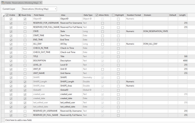

Along with the AreaRoles table, the reservation feature class requires (manually for the current release) adding two new field columns to enable the hotel booking for someone else.
https://doc.arcgis.com/en/indoors/viewer/get-started-with-workspace-reservations.htm#:~:text=Optiona...
Look for "RESERVED_BY_USERNAME" and "RESERVED_BY_FULLNAME" instructions.

Hi Jinko,
This is how we have manually added the required fields onto the Reservations layer:
