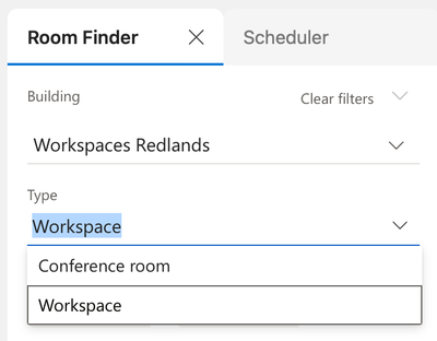

Hello @TomasL44 .. thanks for posting. Can you please confirm:
- You are referring to the 'Workspace' as it appears in Room Finder in Outlook (see screenshot below)?
- The workspace booking goes through without any issues when done inside of Outlook?
TomasL44
@GauravJobanputra This is correct. It is a Workspace in Outlook Room Finder. Also correct, when making a reservation in Outlook, it goes through just fine.

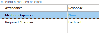

TomasL44
Thanks @GauravJobanputra . Yes, this is very peculiar. To add another clue, I checked the meeting that ended up getting added to my calendar and realized the room is in fact declining the invite.
