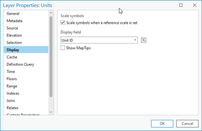

GauravJobanputra
At @Andrew-Bowne I have a solution for you that does not require you to create categories. You can use it if you like. The way you can get it to work is to set UNIT_ID as the Display Field in Pro for the Units layer (it is set to Name by default). Be sure that you still use NAME for labeling. You will now be able to search using characters that match the UNIT_ID and the search suggestions will show the entire value (instead of the name) - see screenshot below.

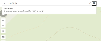

Andrew-Bowne
@GauravJobanputra you were correct, I still had the category configured.  I deleted the category and updated the display field for the UNITS layer and I still can't search by UNIT_ID.  Should this work with Enterprise Portal 11.0?
Searching by a UNIT_ID
GauravJobanputra
@Andrew-Bowne two questions specific to your map:
- Is the Units layer a hosted feature layer or registered feature service or map image layer?
- What is the data type of UNIT_ID? Is it string/text or integer?
