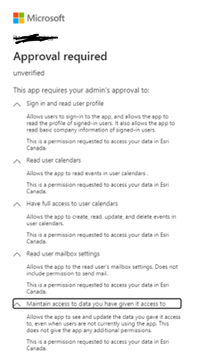

I am looking to integrate an Indoors deployment with Microsoft 365 to enable meeting room and hotel bookings form the Indoors apps. I have configured the reservations layer but users are concerned about the lack of two-way sync and losing the ability to view a room's availability from Outlook as that is what people are used to. Working with IT we have successfully registered the Indoors Viewer app as a multi-tenant app in the Azure Portal and the Microsoft sign-in dialog launches from the Indoors app as expected. However, users are prompted to email the Azure admin for approval to use the app:

Managed to work this out. If anyone is interested, granting your registered app the following delegated permissions for Graph worked for me:
  • User.Read
  • Calendar.Read
  • Calendar.ReadWrite
  • MailboxSettings.Read
  • Open ID Connect scope offline_access
  • Grant tenant-wide admin consent
