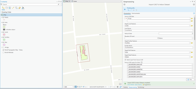

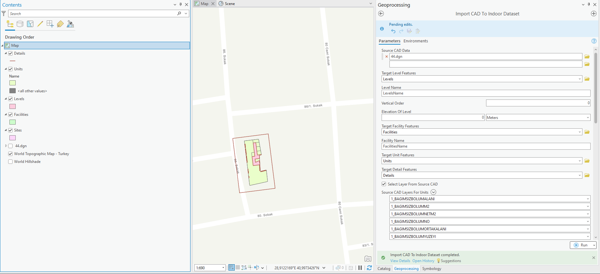

I think that with Import cad to indoor dataset, it imports my cad data to indoor layers without giving any errors.
But I cannot activate the ground filter.
I found that there is no data in some indoor layers.
Can you help me? I am not sure where I made the mistake.
cad file is attached.

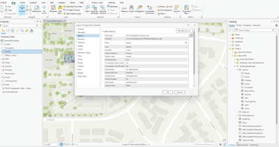

I think you will need go to the properties of each layer and set the "Floors" property there as well.

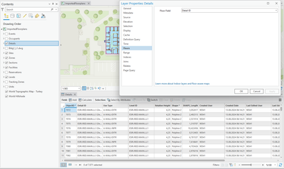

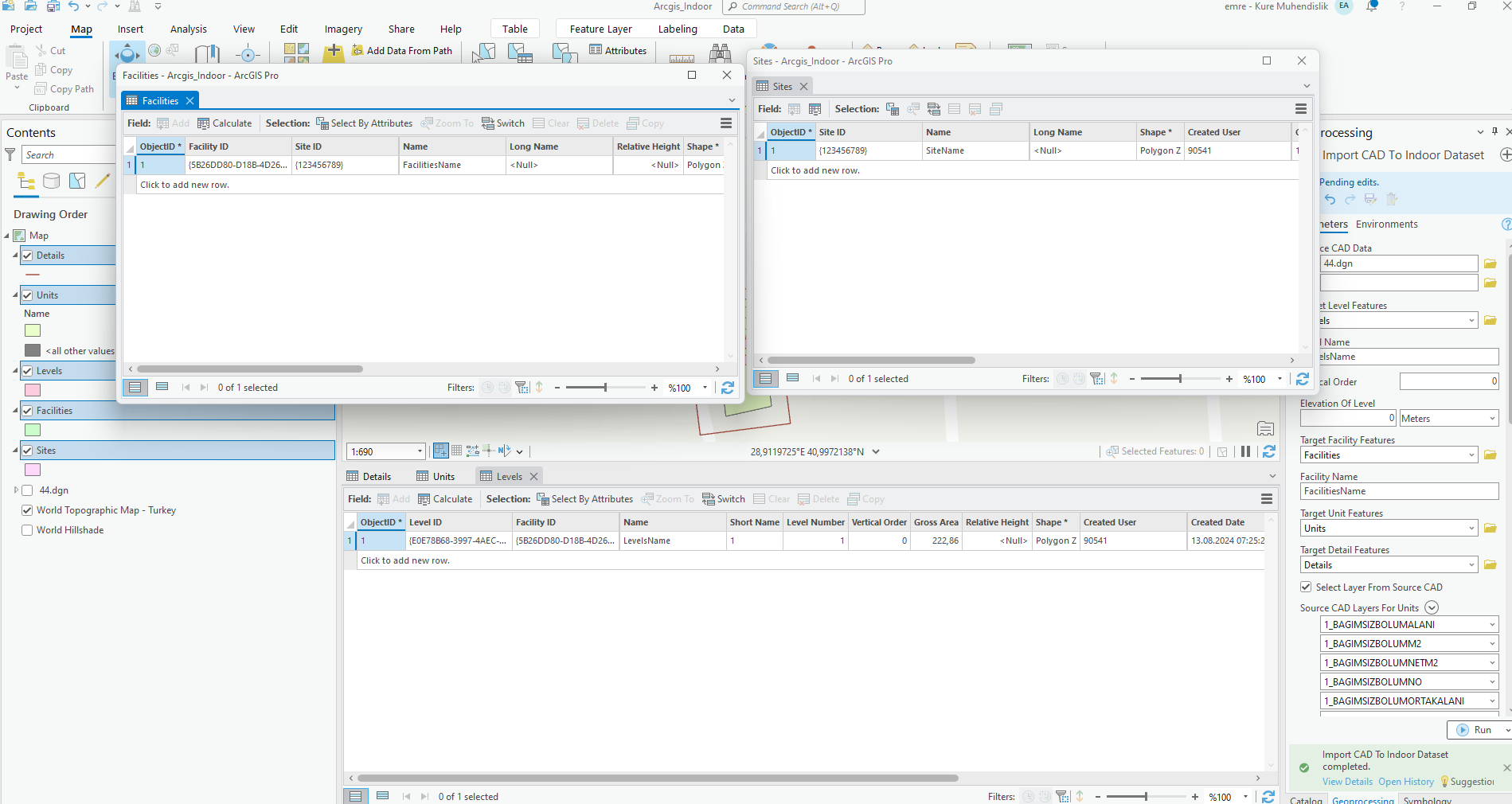

I am not sure how to fill the floor layer here, but I added the ID class to the Floor Field layer as in the sample image, but I still did not get any results.
MichaelJenkins
It would be the Level_ID field.  That is waht floor chooser widget will use to filter out the features to the level you select.

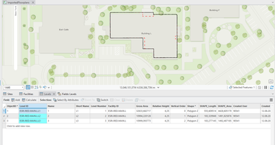

The level ID field is here. I don't know where else it should appear. I would be very happy if you could help.

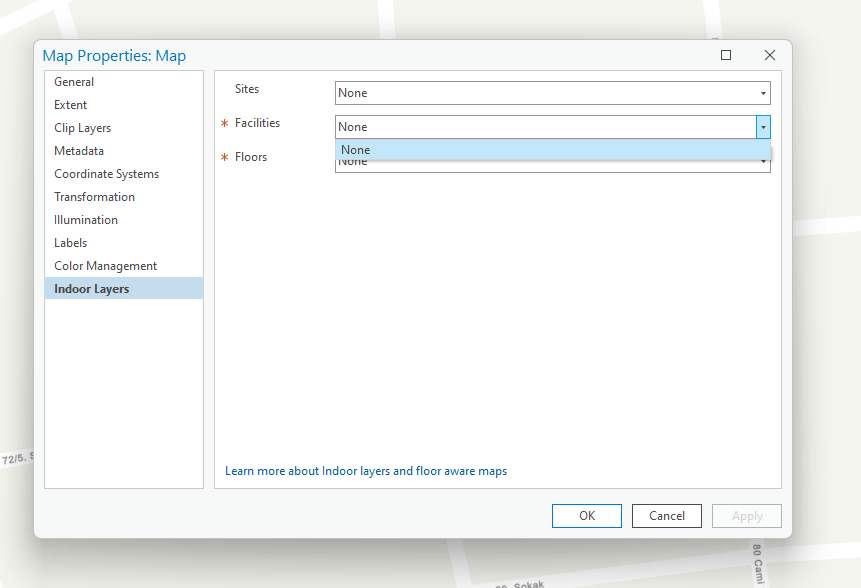

The Details feature class should have a Level ID (LEVEL_ID) field. In the Layer Properties for Details , set the Floors property to the Level ID field. This will make the Details layer floor-aware once the map is floor aware... but from the last screenshot you shared, it looks like the map (ImportedFloorplans) isn't floor aware yet.
Please try:
  1. In the Contents pane, right-click the map (ImportedFloorplans) > Properties > Indoor Layers.
  2. Click the Facilities dropdown and choose Facilities.
  3. Click the Levels dropdown and choose Levels.
  4. Click OK to close the Map Properties.
The map should now be floor aware, and the floor filter should appear in the top-right corner of the map.
