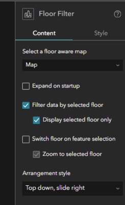

I'm in 11.3. You need to write calculations for unit ID, Level ID, and Facility ID. The experience builder floor filter widget must have these settings in order for the calculations to work correctly:

Hmm, my floor filter widget doesn't appear to have the same settings as your screenshot. I only had calculations set up for Level ID though, I'll have to see if adding calculations for Unit ID and Facility ID helps at all.
Otherwise seems like a good argument for upgrading to a newer version of Enterprise!
