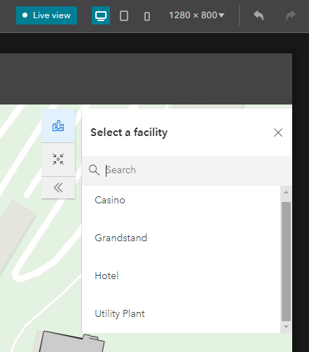

I have an Experience Builder App that has the following widgets:
Map Widget - pointing at a Web Map with a definition query for a subset of facilities
Floor Filter Widget - wired up to the map widget
Branch Version Management Widget - wired to a feature service configured with version management enabled.
What I am encountering is that while in the Experience Builder "Live View", the floor filter widget displays as expected:
When I preview the draft app in a browser, or view the published app, the floor filter widget is grayed out:
Dev Tools tells me I need to have a Facilities and Levels layer for the floor filter to work.  I Definitely have those.
Is this an issue with Branch Versioned data not being compatible with the Floor Filter widget?  If I remove the Branch Version widget, it works fine.

Just did a quick test and it works with my data so don't think there's a fundamental incompatibility with the widget... if you change to the version in Pro do you still see the Facilities and Levels features as expected?
Andrew-Bowne
Yes, When I change the version in Pro I do see the Facilities and levels.
During runtime it almost appears like the floor filter widget is loading before the version management widget.

Shameless Bump...  I'm still experiencing this issue and can't seem to resolve it.
As noted above, it appears that the floor filter widget loads before the version management widget.  Is there a way to force one widget to load before another?
