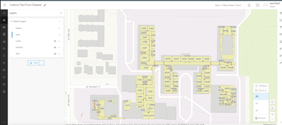

I'm testing out an Indoors viewer. I'm running into an issue where the facilities layer outline is visible, regardless of whether or not the layer is hidden.
Web map:

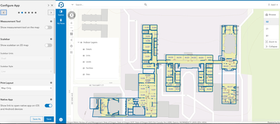

Indoors viewer (facilities outline in blue):

Andrew-Bowne
I believe this is by design.  It provides a visual cue to show you what facility the floor picker is associated to.
LeviCecil
I hope not, It looks awful!
LeviCecil
There has to be a way to turn this off?
Andrew-Bowne
Not that I am aware of.  Also, I don't believe there is a way to change the color either.
