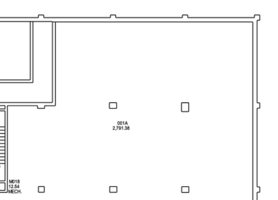

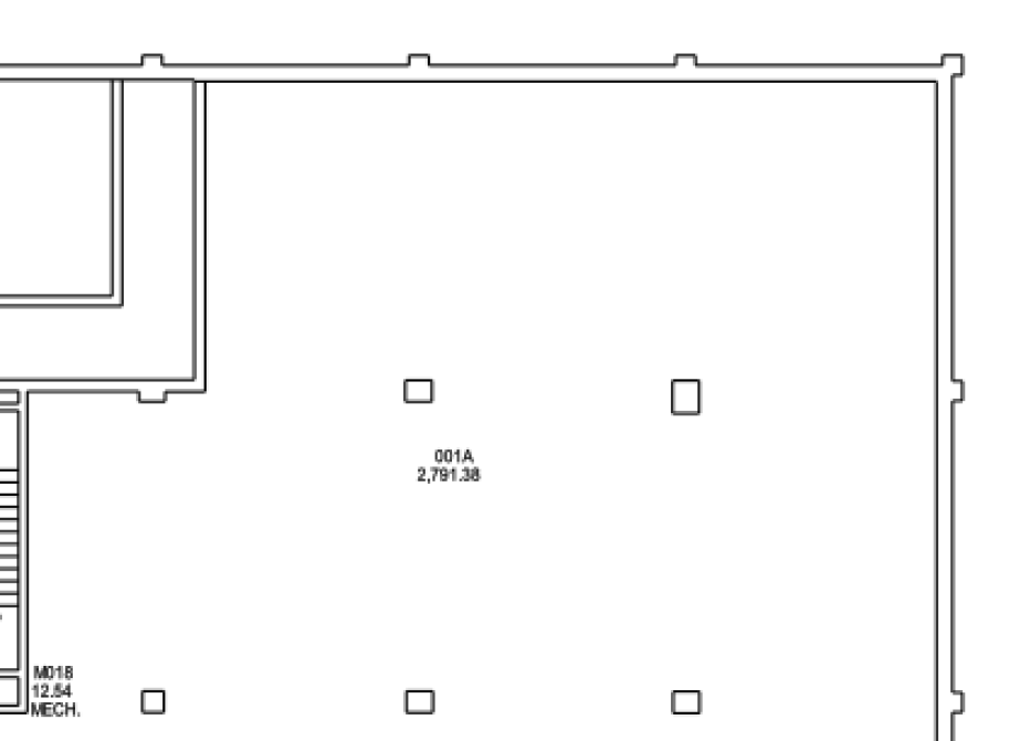

I am just getting started with Indoors and have received CAD files for our facility. For the units layer, there are multiple annotation anchor points, and only one makes it into the target field. Since I don't have control over how the CAD is created or organized, is there a way for me to instruct the import CAD script to capture all annotations? For a specific example, see the image below. I want the 001A to be carried over, but instead M018 is the only thing that makes it.
Or do I need to do some manual splitting/filtering of the input CAD prior to running the script? Thanks for any guidance.

Thanks for the detailed question and example screenshot! Unfortunately, as you've discovered, when there are multiple CAD annotations in a unit space (like in your example), ArcGIS Indoors will only import one of them.
The Import Floorplans To Indoors Geodatabase tool uses the CAD annotation's anchor point to determine the associated unit space. The preferred way to address the issue in your example would be to reposition the CAD annotation for M018 so that its anchor point is positioned in the correct unit space, rather than in unit 001A. You mention that you don't have control over how the CAD data is organized, so that may not be an option for you.
