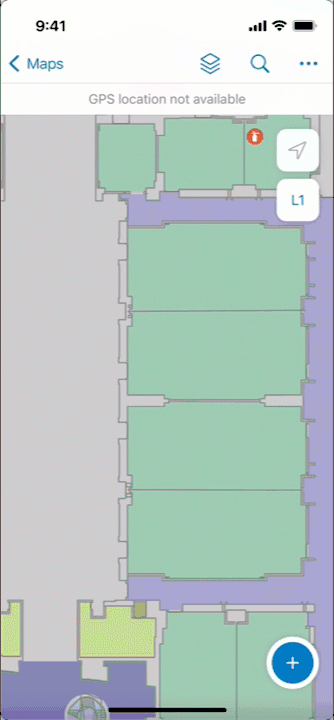

Hi @ReshmiMukherjee I wanted to follow-up to ask if you were able to get this working? I was particularly interested in knowing why you were performing this step?
  • Created a domain (all the LEVEL_IDs for the building) for the LEVEL_ID field. The value of the field would be passed as parameter to the Units layer and populate the rest of the fields in the asset layer. Thereby making the asset layer dynamically floor aware.
Anyways, FieldMaps supports collecting floor-aware features since a few releases. I have included a short demo below. Unless I am missing something, you should not need to pass the level info.

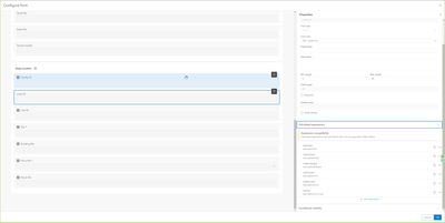

We are having a similar issue with editing features in Experience Builder using the editor widget. We do not want our customers to edit indoor data, so we created a customer review layer. This layer is floor aware with a Level_ID field. We want to use Forms to populate the level id dynamically based on an arcade function. However, when you go to format the Form, Level_ID is not an option to format. Yes this works if our editors were using Field Maps, but they are in an office and using the Experience Builder application.
Any ideas?
