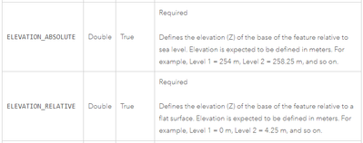

Tim_McGinnes
As far as I know it already does support absolute elevations. In the ArcGIS Indoors Information Model it has both  ELEVATION_ABSOLUTE and ELEVATION_RELATIVE fields.
Your actual geometry should also be possible to store in either absolute (z above sea level) or relative (z above ground). When you setup your 3D scene just choose the appropriate setting "At an absolute height" or "Relative to the ground".

Suleyman-Arslan
Your absolutely right. Data model contains both of them.
https://doc.arcgis.com/en/indoors/viewer/prepare-a-scene-for-indoor-viewer.htm
Everywhere in documentation they mention to use relative elevation
