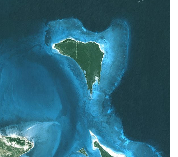

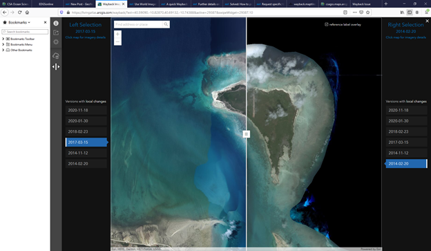

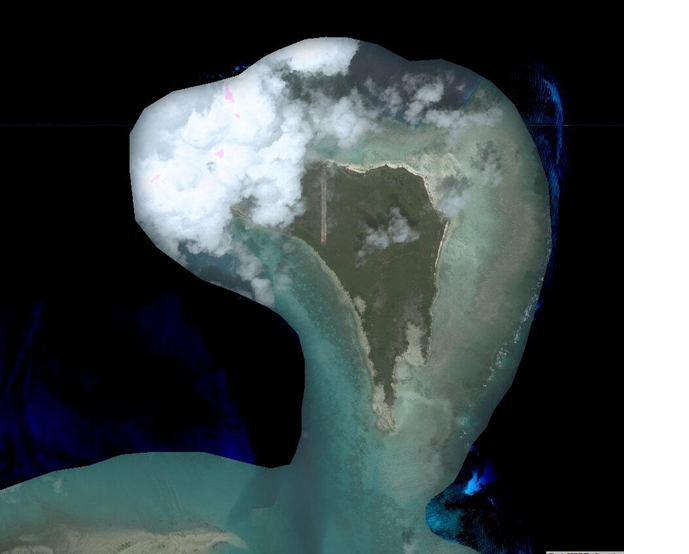

In the HTML example below the tileMatrixSet and identifier are set to display the imagery from Wayback on 2017-03-15. Zooming in once will correctly get data from 3-15-2017. But zooming in again will switch to 4-20-2014 data See figures 1-3
What does it switch, and how can I determine when it will switch and to what date.
