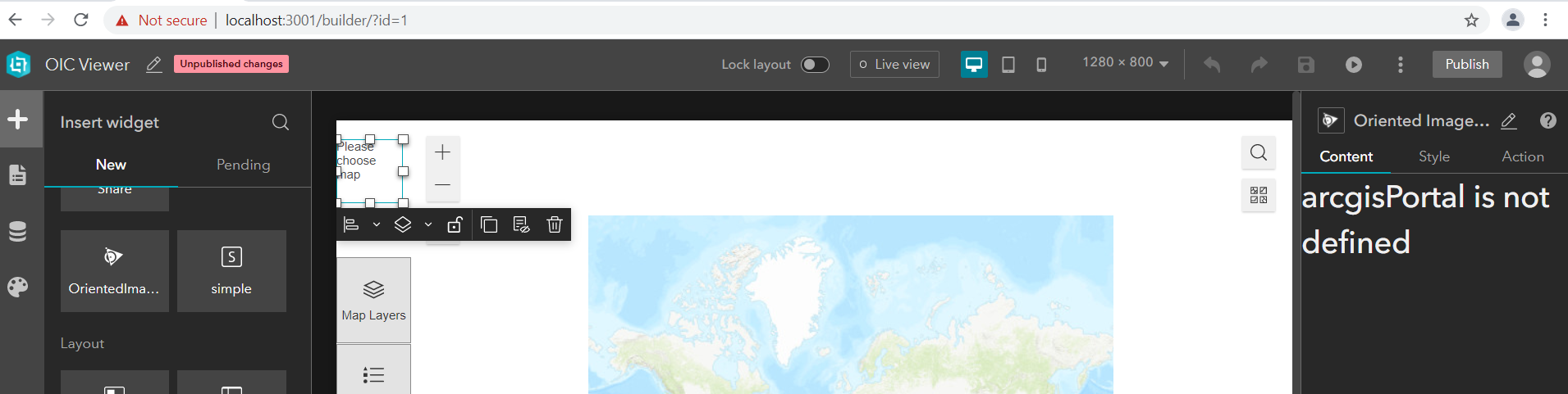

I was trying to replicate this Esri demo web for viewing OIC. I installed the Experience Builder using the installation steps on the website. I the started the server and client. Also I had previously download the widget from GitHub and extracted it to the appropriate client folder.
The Oriented Imagery widget is showing on my list of widget when I start the Experience Builder, however, when I add the widget is shows "arcgisPortal is not defined", is this normal and how can this be fixed.
I did create the app on the Enterprise portal and copied the app ID to the experience builder during the log-in.

Hi,
Which version of Experience Builder (Dev Edition) are you using? If it is 1.4, then this is a known issue and will be fixed in the next release of Oriented Imagery. Can you please try with version 1.3? Widget works in Experience Builder version 1.3 or below.

Hi,
Thank you, yes I was using version 1.4. I got version 1.3, tried it and it worked. Thanks.
