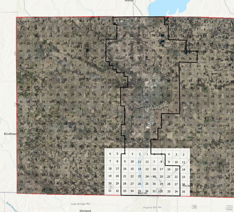

My end goal is to have an image service that has downloadable tiles in our open data portal. This dataset will also serve as our imagery basemap. (Unless that's a bad idea to have the open data and the basemap from the same service. If so, let me know, please and I'll duplicate this or the service.) I haven't ever done this before. The total area is 720 sq miles. Most of it is 6" resolution and there is a 3" resolution inset up the center (inside the black outline.) The imagery is 4-band MrSID, but I have it designated as Natural Color. I haven't done statistics or analyzed it yet. Other things to note, I am using ArcGIS Pro 3.3.1 and our server is 10.9.1. I do have access to Pro 2.9.x, and we are upgrading our server next month to 11.3 or .4. (I can't remember which. whatever the latest not ".0" version is. That's IT's call.)
I know there are overviews drawing for that area at larger scales. It looks like they pop in at about 1:41000. What can I do to get them to draw at the same levels as the rest of the dataset? I would appreciate any help or advice.
I used this workflow:
  • Created the mosaic dataset
  • Defined Overviews
  • Added my 6" tiles
  • Added my 3" tiles
  • Defined Overviews to set the output location. I left all other parameters as their default settings.

  • Then I tried Generating Missing Overviews only a couple of times the first result was:
Build Overviews
Parameters
Mosaic Dataset     ...
Query Definition
Define Missing Overview Tiles     DEFINE_MISSING_TILES
Generate Overviews     NO_GENERATE_OVERVIEWS
Generate Missing Overview Images Only     IGNORE_MISSING_IMAGES
Regenerate Stale Overview Images Only     IGNORE_STALE_IMAGES
Updated Mosaic Dataset     ...
Messages
Start Time: Thursday, December 19, 2024 4:29:11 PM
2024-12-19T16:29:20.417: Defining overviews
2024-12-19T16:29:20.744: Defining overviews for pixel size: 0.4444444444444444
2024-12-19T16:29:23.031: Defining overviews for pixel size: 1.333333333333333
2024-12-19T16:29:25.237: Defining overviews for pixel size: 4
2024-12-19T16:29:26.700: Defining overviews for pixel size: 12
2024-12-19T16:29:26.873: Defining overviews for pixel size: 36
2024-12-19T16:29:26.960: Defining overviews for pixel size: 108
2024-12-19T16:29:27.068: Defining overviews for pixel size: 324
2024-12-19T16:29:27.151: Defining overviews for pixel size: 972
2024-12-19T16:29:27.239: Identified 6 overview levels at cell sizes: { 4 12 36 108 324 972 }
2024-12-19T16:29:27.351: Removed 0 mosaic dataset items and 0 unreferenced raster type instances.
2024-12-19T16:29:27.938: Loading raster datasets
2024-12-19T16:29:28.384: Constructing overview items: region 1 of 1 at cell size 4
2024-12-19T16:29:29.170: Constructing overview items: region 1 of 1 at cell size 12
2024-12-19T16:29:29.325: Constructing overview items: region 1 of 1 at cell size 36
2024-12-19T16:29:29.379: Constructing overview items: region 1 of 1 at cell size 108
2024-12-19T16:29:29.405: Constructing overview items: region 1 of 1 at cell size 324
2024-12-19T16:29:29.429: Constructing overview items: region 1 of 1 at cell size 972
2024-12-19T16:29:29.456: Completed crawling 82 data source items. Added 82 mosaic dataset items.
2024-12-19T16:29:29.713: Processing duplicate mosaic dataset items
2024-12-19T16:29:30.332: Removed 82 duplicate mosaic dataset items.
2024-12-19T16:29:32.391: Synchronizing items associated with raster type instance 'Overview Instance 23' [ID: 23].
2024-12-19T16:29:46.686: Completed synchronization: 82 items selected, 82 items synchronized.
2024-12-19T16:29:46.719: Computing cell size levels
2024-12-19T16:29:46.722: Computing unique cell size values
2024-12-19T16:29:55.683: Computing maximum cell size values
2024-12-19T16:29:56.141: Updating maximum cell size values
2024-12-19T16:29:56.194: Computing minimum cell size values
2024-12-19T16:29:58.004: Updating visibility values of selected items
2024-12-19T16:29:58.098: Updating visibility values of selected items
2024-12-19T16:29:58.148: Computing maximum cell size for mosaic dataset
2024-12-19T16:29:58.204: Completed computing cell size ranges.
2024-12-19T16:29:58.207: Completed defining overviews
Succeeded at Thursday, December 19, 2024 4:30:14 PM (Elapsed Time: 1 minutes 2 seconds)
  • The second result was:
Build Overviews
Parameters
Mosaic Dataset     ...
Query Definition
Define Missing Overview Tiles     NO_DEFINE_MISSING_TILES
Generate Overviews     GENERATE_OVERVIEWS
Generate Missing Overview Images Only     GENERATE_MISSING_IMAGES
Messages
Start Time: Thursday, December 19, 2024 4:31:31 PM
2024-12-19T16:31:39.965: Marking stale and missing overview items
2024-12-19T16:31:43.255: Overview items marked for generation: 0
Succeeded at Thursday, December 19, 2024 4:31:57 PM (Elapsed Time: 26.44 seconds)
This is where I am now.
JenniferBorlick
Found a solution:
Coming back to this question. I was able to fix it by defining overviews with -1 set as the Number of Layers. Then I built the overviews with Define missing overview unchecked.
Found the solution here.
