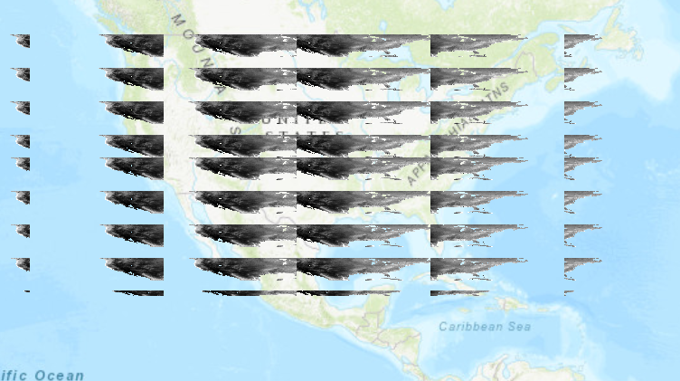

I am using ArcGIS Pro's "Resample" raster function to resample an imagery layer (time enabled). I run the resampling using Image Server raster analysis, result is saved as Imagery Layer (hosted).
When I use "Bilinear" ResamplingType, it works, but it does not work with "Average" and produces a really bad result like the following one.
When I use "Majority" as the ResamplingType, it throws the following error.
