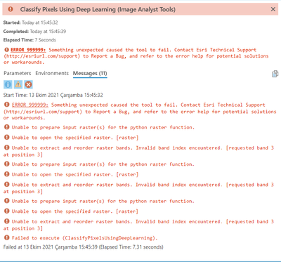

şevvalbulut
Hi ,
I have same error. Continuously giving an ERROR 999999. Runs the process 2% only then gives error
I'm currently on ArcGIS Pro 2.8.3
I use this model https://www.arcgis.com/home/item.html?id=e732ee81a9c14c238a14df554a8e3225 for landsat 8
I setted the processing template to None , i'm still receiving the same error message

şevvalbulut
Hi Sandeep
Thanks
by Anonymous User
Not applicable
Hi,
It seems that your training data had 4 or more bands but the image you are trying to deploy your model on has only 3 bands.
These models expect same number of bands in target imagery as in the training data.
You can try to retrain the model with fewer bands same as in target imagery, you might need to rexport the training data. If it was only alpha channel in the training imagery, you can just add one more constant band in the target imagery.
Thanks,
Sandeep
