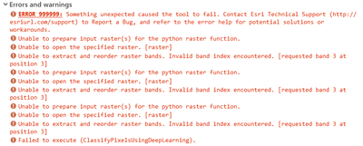

Dear Community,
attempted to classify pixels using deep learning by applying the Land Cover Classification dlpk.
However, an error returned: Error 999999

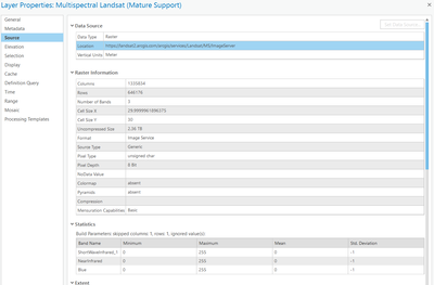

- Information on the input raster you are using - Type, Bands, Bits per Pixel, Columns, Rows, Coordinate System etc.

As for the information on the input raster, I was trying out with Multispectral Landsat imagery found on Living Atlas: https://landsat2.arcgis.com/arcgis/services/Landsat/MS/ImageServer
Tim_McGinnes
By default the Landsat service will show you a 3 band combination, but the deep learning model expects 7 bands. In the properties of the Landsat service under Processing Templates, you need to set the Processing Template to None. Worked for me ok once I did that. You should probably set your required extent in the environment variables as well.

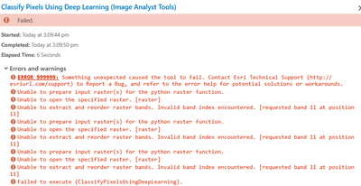

Hi Tim,
Thanks for the tip. unfortunately, even after setting the processing template to None, and trying out on the extent in the example you have shared,  i'm still receiving the same error message:
Tim_McGinnes
Well it's a slightly different error this time. My only suggestion now would be to go back to using the default Python environment (arcgispro-py3). What did you mean when you said it was "unable to read the dlpk"? I am also on Pro 2.7.2, and used the deep learning framework from the installer and using the default environment.
