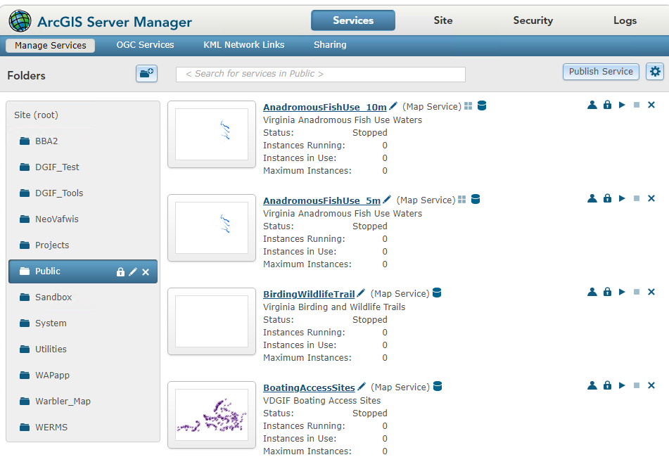

I dont see a space for ArcGIS Server 10.5.1... only this space for Prior to 10.0
Is there a way (in ArcGIS Server 10.5.1) that I can run a report that will list out the Root...Group..Services  of my server instance with their corresponding Services
Example:  Listing the Root, Service, and RestEndpoints (Map, KML, Feature)  for each Root Site in the Server Instance.

I see that there is quite a bit of info and xml files that I can datamine here: C:\arcgisserver\
But not sure where to find the information I am seeking...if its even there.
again trying to list Every Root Site - With the Service Names and the RestEndPoints for each of the services (map, KML, Feature) See my initial post for this format.
Any thoughts?
