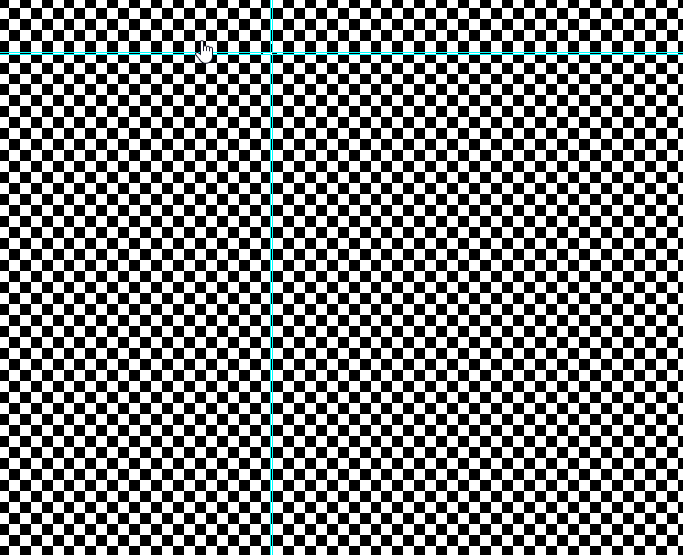

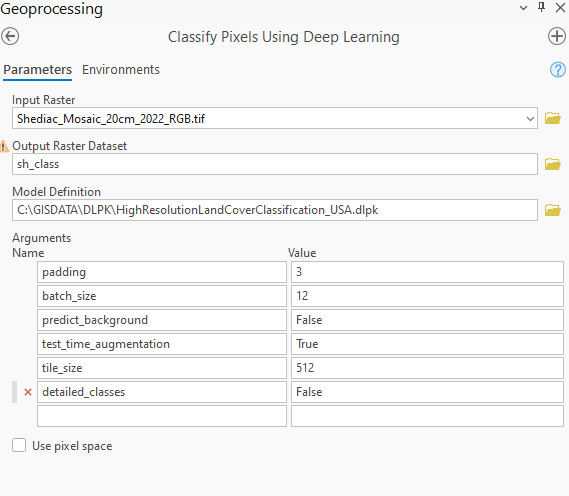

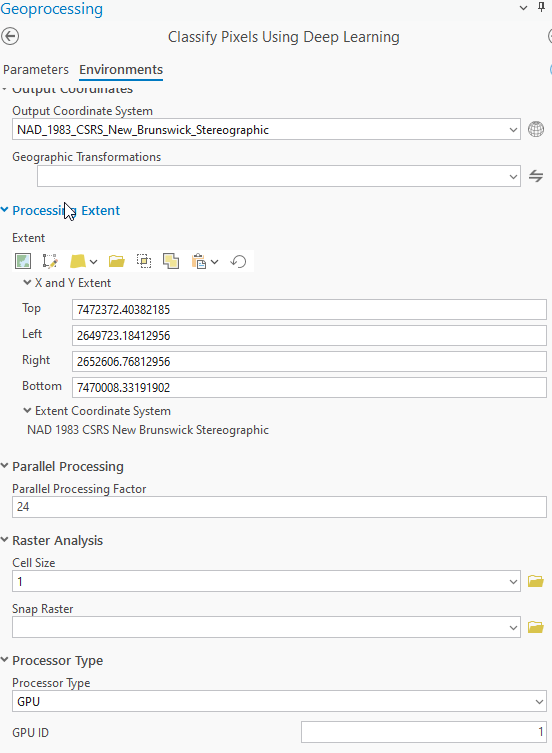

I'm getting this result (Figure 1) from running HighResolutionLandCoverClassification_USA.dlpk using "Classify Pixels Using Deep Learning" on Figure 2. Any insight on why this is happening would be appreciated. Figure 3 shows arguments, Figure 4. Environments.
1. Output Raster Dataset (Value 0 to 254):

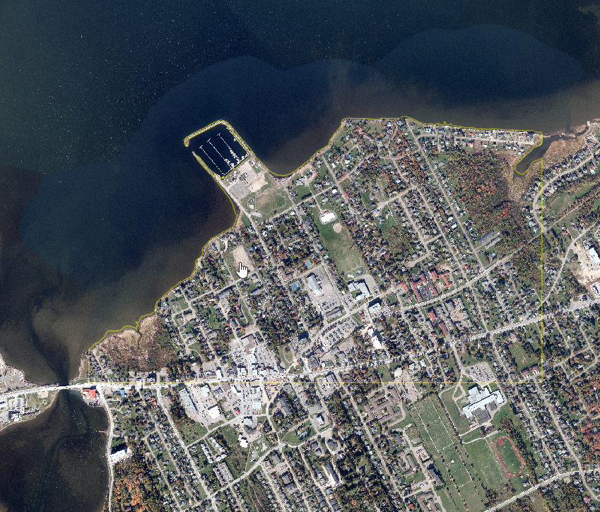

Figure 2. Original image (RGB, 0.2m resolution, 8-bit unsigned)
Figure 3. Parameters: Arguments
Figure 4: Parameters: Environments

@InukSimard the output appears to be empty (likely nodata pixels). Can you try a small area with:
  1. GPU (don't use Parallel Processing Factor, it's for CPU)
  2. CPU without parallel processing factor
  3. CPU with parallel processing factor
Please share which of three works for you. Also, please share what version of ArcGIS Pro you're using.
