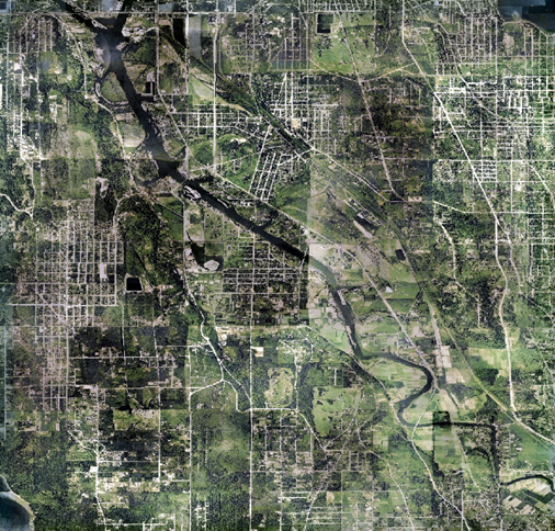

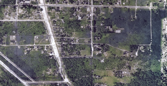

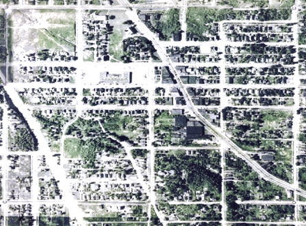

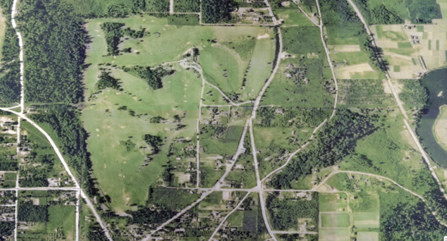

Here are some examples of my results colorizing 1936 imagery of Seattle.  As you can see, the uneven exposure across the orthomosaic isn't helping the results, but when zoomed in to mid-tone areas the results are quite nice:
Good results in this area with well-balanced exposure.Good results in this area with well-balanced exposure.A golf course in 1936: Forest, fields, and sand traps all nicely colored.A golf course in 1936: Forest, fields, and sand traps all nicely colored.Underexposed area: Some darker areas are mistaken for water and given bluish tones.  Houses receive no colorUnderexposed area: Some darker areas are mistaken for water and given bluish tones. Houses receive no colorOrthomosaic.  Uneven exposure across photo frames doesn't help things, but in general, forests and fields are green.Orthomosaic. Uneven exposure across photo frames doesn't help things, but in general, forests and fields are green.Overexposed area: Obvious issues.  It's important to make sure target images are well-balanced before processing.Overexposed area: Obvious issues. It's important to make sure target images are well-balanced before processing.
