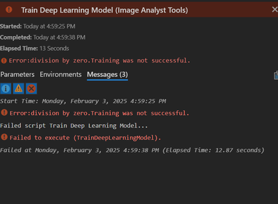

The Train Deep Learning Model is failing on me in ArcGIS Pro 3.4.2 even though I have even number of training features.
I am btw also using a pre-trained model (Water Body Extraction (SAR) - USA) as well in the tool.

Here's a snippet of stat file
Tool
Error
@PavanYadav any clues?

I am on the latest version of Pro that is 3.4.2. I am surprised that it's giving me the zero division error, because as you can see in the above stat file screenshot, the training data has 600 features.

hi @Ed_ we need to handle this error bit better and provide you with actionable information. One reason that I have seen this occur is that when the batch size is larger than the number of chips in the data, the Train Deep Learning Model tool may return  "ZeroDivisionError: division by zero" in this case.
It looks like you have 5 images chips and your batch size if 8.

Hi Pavan, happy Friday, thank you for the response, so in this case what should be batch size then?

@Ed_ you can try 2, but to be honest; I would have at least 50-100 samples just to be on the safer side.. I see your tile size is 512, which could be fairly large for your GPU.. maybe decease it  to 256 and use a stride of 128.. these will produce a lot more image chips..

i do have 600 training features, so what do you mean by 50-100 samples? Are those the number of image chips?
I do have Nvidia RTX A2000 12 gig, so should i still decrease the tile size?
