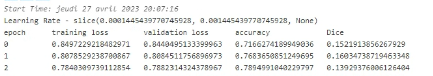

Here the results after 49 epochs (just gave you the 3 first):

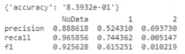

I think that the NoData (0 in image labels) sort of dilutes the overall accuracy because my targeted habitat patches are quite rare in the landscape, there are a lot of 0 values in the images used to train the model. And I didn't find a way to class balance the nodata (tried ignore_classes = [0] didn't work). I also tried to train a model jst over the habitat patches but didn't improve.
Do you think that my guess about NoData is good? Should I look somewhere else?

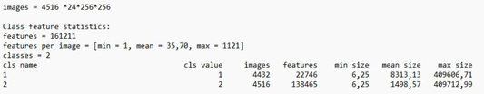

4.
