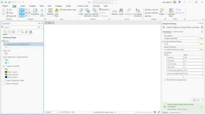

My line and polygon didnt shows up on detect object using deep learning
773
02-28-2024 12:50 AM
arifsyakir
idk what is my mistake here, im still newbie here on using deep learning,pleas help me thank you 🙂

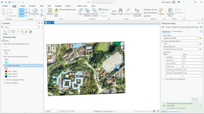

@arifsyakir I see you're trying to use TreeDetection.dlpk. Is it downloaded from here: https://doc.arcgis.com/en/pretrained-models/latest/imagery/using-tree-detection.htm. If so please make sure your input data is - 8 bit, 3-band high-resolution (10-25 cm) imagery. You can read more info at the above page or the model page. It may not work well, with low resolution input images.
(if above suggestion does not work just for a test please try to use CPU from the Environment settings (Processor Type).. , just to see if it makes any difference).
