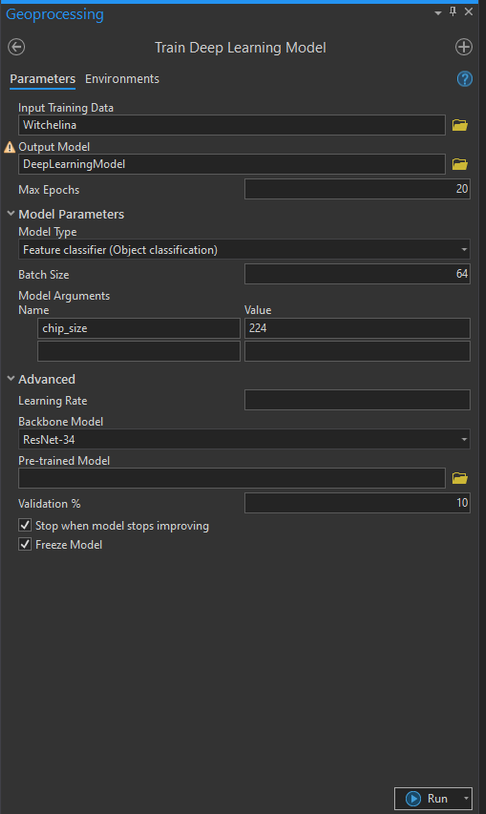

I was relieved that my export training samples and train deep learning model went well without a hitch.
Export Training DataExport Training Data
Train Deep Learning ModelTrain Deep Learning Model

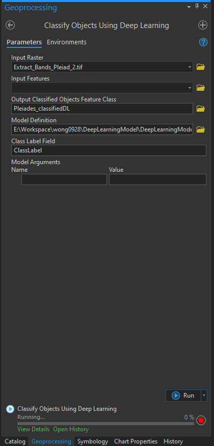

However, trying to run the Classify tool on my raster was not successful. The process would waver between 0-1%. I left it overnight for processing with the same situation where it would be stuck at 0%. Is there a reason why the tool is not running on my raster? Is it because of the background pixels in my raster?
Classify Objects using DLClassify Objects using DL
Appreciate any comments or thoughts on my issue.

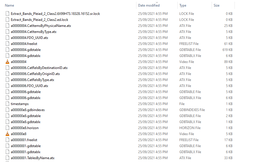

these files below were created while the tool was in process but nothing else eventuated while the process got stuck at 0%
