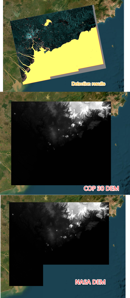

Duncan, thanks for sharing the dataset.
I was able to generate detection results from running Extract Water tool in 3.6.2 and 3.6.0 using either NASADEM or COP30 DEM. The steps I took are 1. Apply Radiometric Calibration (Gamma Nought) -> 2. Extract Water.
Then, 1. Apply Radiometric Calibration (Gamma Nought) -> 2. Apply Radiometric Terrain Flattening -> 3. Extract Water also runs through successfully.
Please kindly try the DEM here: S1_duncan_dem.zip. Let me know if you are still seeing the issues.
If you are able to share your DEM, that would be awesome.
My email address is [email protected].
Aote
