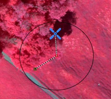

There is another example:
The interpreters must digitize the forest boundary line. Around the last vertex of the sketch, there is a circle with 25 m radius. The purpose of this circle is to indicate the area in which the next vertex has to be placed (the distance between vertices must be < 25 m):
The workflow with a 3D mouse looks as follows:
  1. When the interpreter starts digitizing, she clicks on a 3D mouse button --> this is a custom button that digitizes the first vertex, and draws a circle around it (using SDK function MapView.Active.AddOverlay()).
  2. Repeat this step until forest boundary line is finished.
