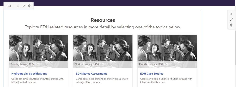

Unable to interactive edit Card images in HUB.  I can edit Text and Hyperlinks in the cards, and I can edit HTML code for cards, but no setting menu displays to allow me to interactively edit the card image when I hover over or click on a card.

Unfortunately, this is correct. The plugin that we use for our Text Card does not support image editing the same way our Image Card does, so modifying the image through the WYSIWYG experience wouldn't yield consistent results. Those cards are part of our code snippets we include in the editor and do require a little bit of HTML knowledge to change the image, but in doing so you're more likely to maintain the code structure that keeps them visually consistent.
You might consider using our Gallery Card if you don't feel comfortable with HTML, as it handles dynamic injection of thumbnails based on the item details. Both Gallery Card and Image Card will also handle responsive resizing automatically for images.

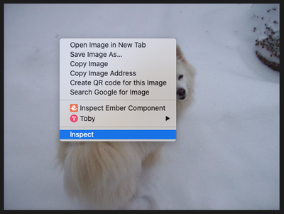

Once you have the image you want to use attached to the site as a resource, if you are using a mouse, right-click the image and select Inspect from the dropdown menu. (I'm on Chrome, so the next few screenshots will be depicting Chrome.)
