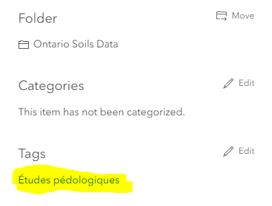

DJB
It is now 2024 and it appears that this is still an issue.  I'm trying to use a tag in the Tag Query in a Hub page that I've created and it does not show up as an option.
As you can see below, it is in my metadata record...
But cannot be found in Hub.
Esri, any idea when this will be fixed.  It's been four years now.
