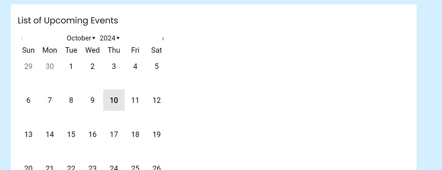

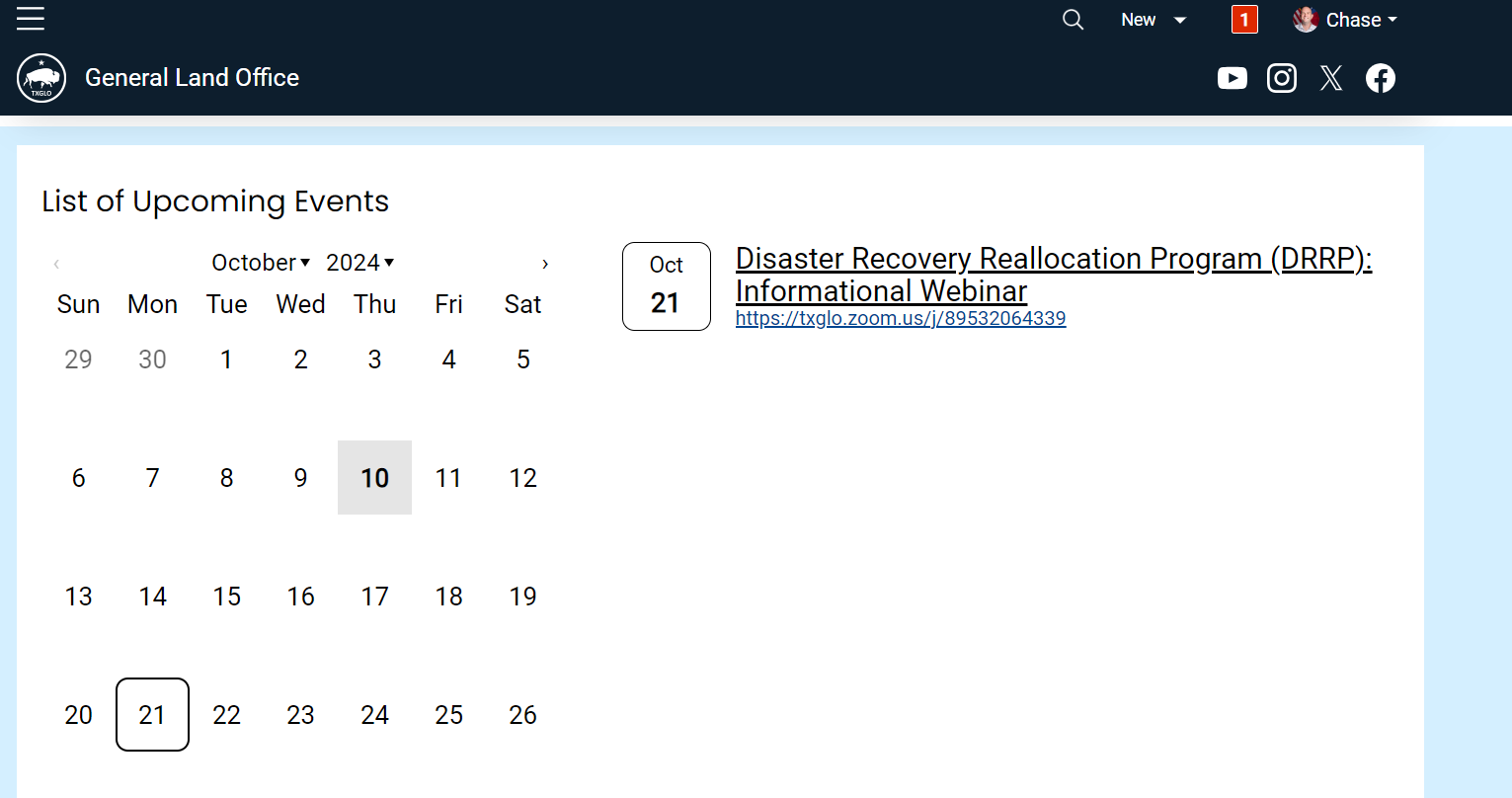

My issue is that when testing with a community account, I do not see the calendar event. But the event is public. What gives?
See the screenshots below. The first is when I'm logged in as an admin, the second when I'm logged in as a community account/follower.

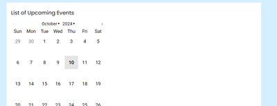

I'm not sure if this will be helpful, but I found that I needed to set Events to Public in two places. First, for the events themselves as I create them (or they can be edited to make this switch).
Also, though, from the Contents page, you will need to:
1. Select the Hub Events dataset for your initiative (and choose View Details).
2. Select the Edit Settings popup that appears on the left-hand side of the screen (location of access to this may change for anyone reading this in the future).
3. On the upper right-hand corner of the page that opens, you'll see Viewer Content and Share buttons. Frankly, it's hard to tell that these are buttons at all until you hover over them, but if you don't have the globe icon (Public) next to Share, then you know that you'll know right away that you'll need to edit that. Click on Share and change your sharing preference accordingly.
I've included some screenshots for these steps.
