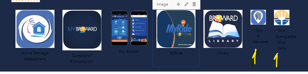

I have a bunch of `image cards` in a `row` card, however I am unable to all of them have the same size. The `Scale Image to Fill` option does not work either. Like no matter what I am unable to have the last two image cards have the same size as the rest of the image cards.
How can I fix this?

Hello @Ed_,
You are likely running into issues because you have 7 images and Hub uses a 12-column grid system to define our rows. At the moment you have 5 image cards that are each 2-columns wide (utilizing 10 columns) and that leaves you with only 2 spare columns of space, so each one of your remaining image cards can only be 1-column wide. You may want to consider stacking your images in two rows and adding spacers on either side.

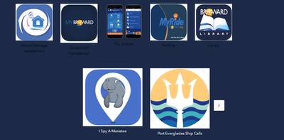

Ed_
by MVP Regular Contributor
Hi Klara, thank you for the quick response. However, this is not an ideal solution as you can see below that the image cards don't have the same size in both rows. Now, I know I can fix that by adding more spacers in the second row but, that's like a quick hack fix.
An ideal solution would be to have the ability to resize the image card just like in Adobe and/or Experience Builder.
Question | Analyze | Visualize
KlaraSchmitt
@Ed_
Yes, I understand it's not ideal. However, until we redo our grid structure, which is a large-scale effort that is in fact on our radar, we're limited in how we can handle card resizing and the total columns used by cards in a row must equal 12. And yes, if you do not wish to write HTML to achieve your desired affect in a single 12-column Text Card, I would advise the use of more spacers.
