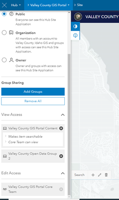

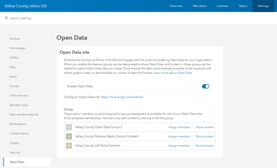

@NEidenAZ When you go to your Organization Settings, do they show that Open Data Portal is selected and that your content groups are added like the below image?

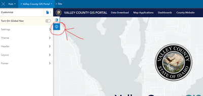

If those settings are right, When you are in your Hub page, there is a little blue icon shown in the first image below (left), does it show the settings like my second image below (right)?
NEidenAZ
@KaraUtter Under Open Data, there were no groups listed. It was then that I realized that the Group was set so that only Group Members could see it. I changed the sharing of the content group to Public and Voila! Problem solved.
