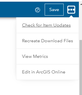

  • I resolved this issue by manually updating the AGOL feature layer item tag, which seems to have caused Hub to search for item updates.
  • From speaking with Esri Support, it looks like you can also force Hub to look for updates on all content through the Content Library (upper right < Check for Content Updates)- which seems to send a harvest call to opendata.arcgis.com: https://opendata.arcgis.com/api/v3/jobs/site/53f0be9030ac4298814b66f4a8c7faa8/harvest

  • In speaking with Esri Support, we found that at the dataset level, you can go in and choose to manually "Recreate Download Files". However, we have ~55 layers that change either daily, weekly, or adhoc (and I'm a shop of 1) so I can't go in daily and manually run this update for all of our data.
  • It looks like when I choose to Recreate the Download Files, I get a "File creation failed" error but I have a feeling it maybe a false flag, and it's actually working...as only the Delete call is getting a 403 server error (screenshot).
  • Would it be possible to script this "Recreate Download Files" and run daily via the Python API to ensure our data downloads are fresh / current as well?

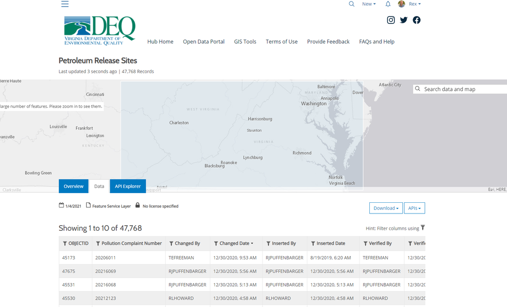

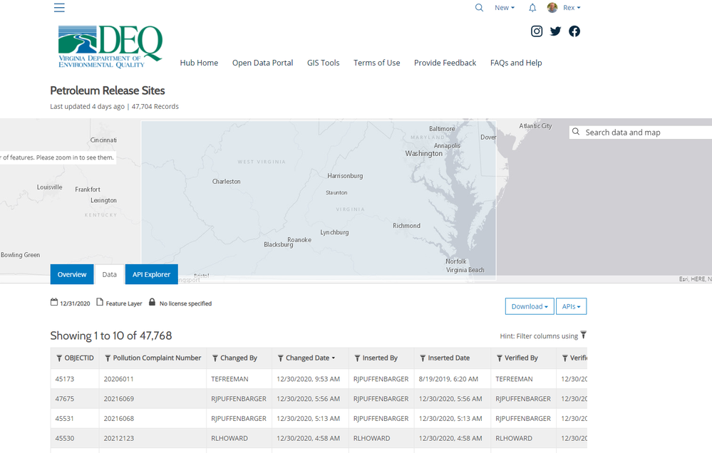

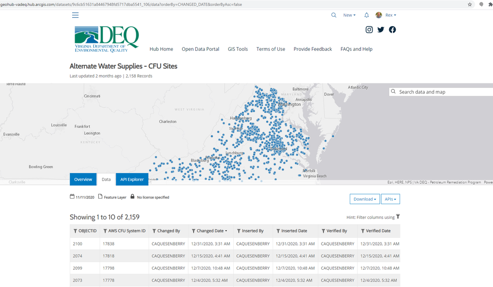

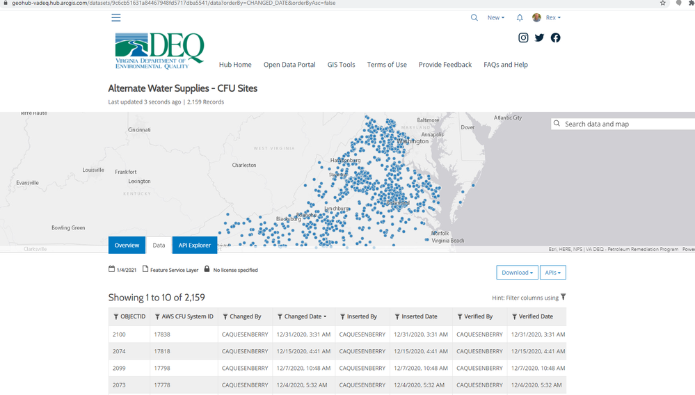

I wanted to take a moment to post a little update on something I noticed today that I'm sure is related to the behavior noted in the first post just in case it's helpful. I noticed today while reviewing a couple of our downloadable Data Hub layers, that the dataset metadata (last updated and record count...along with (I presume) the map) is out of date / synch with the underlying data both within the service REST endpoint, and even within the attribute table in the Hub Data Page. Below are a couple of examples. For both of these datasets, manually going into the item, and checking for updates (I also recreated the download files...because why not?) resolved the issue. However this gets back to the manual vs automated update problem. I'm guessing this will be addressed in the 2021 enhancement you noted but thought this was good to mention just in case.
Here, we can see that there was a record updated on 12/31/20, and the actual record count should be 2,159. The layer metadata is showing it was last updated 2 months ago (incorrect) and is missing at least the latest record (2,158 records). Again, this can be pretty misleading both to our internal editors / data users, and external consumers of our datasets.
The next example is also a little perplexing... In this example, there were several updates on 12/30/20 and the metadata shows a last update of 4 days ago...which is at least close- but the record count is seriously off- by almost 60. Again, a manual update seems to have refreshed things:
