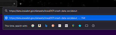

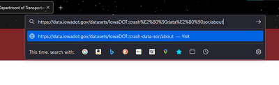

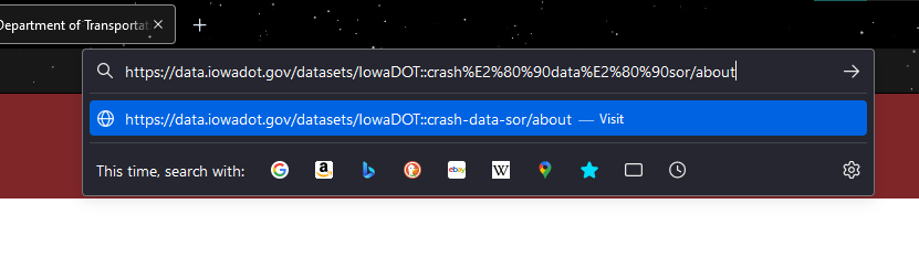

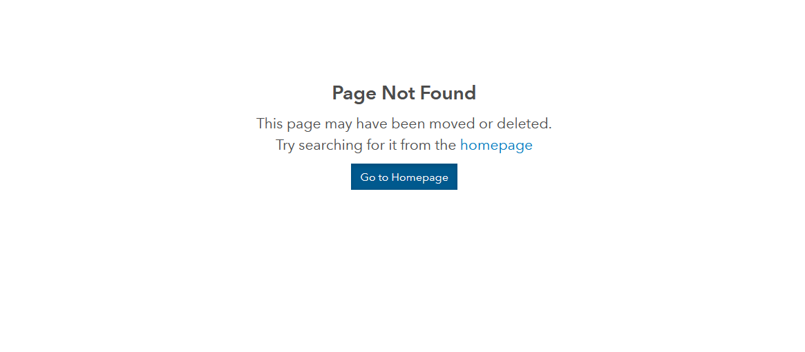

I am not really sure what's going on here but would appreciate some insight. I have datasets that need to be linked within a grant application, but each time I click or even copy and paste the links from the PDF used in the application, it replaces some of the string. For one hub, it replaces some of it with what looks like HTML:
https://data.iowadot.gov/datasets/IowaDOT::crash-data-sor/about
becomes

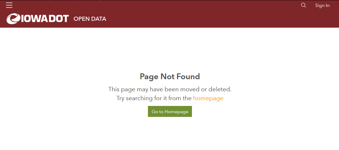

https://data.iowadot.gov/datasets/IowaDOT::crash%E2%80%90data%E2%80%90sor/about
and returns this error:

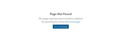

Similar situation happens on the Illinois side, with some even stranger replacements:
https://gis-idot.opendata.arcgis.com/search?collection=Dataset&q=Roadway%20Crash%20Data
becomes
https://xn--gisidot-706c.opendata.arcgis.com/search?collection=Dataset&q=Roadway%20Crash%20Data
and returns a similar error with 'homepage' links that don't actually go anywhere:

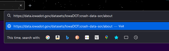

If I copy and paste these links from anywhere BUT the PDF, they work fine. If I copy and paste them from the PDF, even they paste fine but change after hitting return. The Iowa URL flashes the alternate URL and then displays the original link again; copying and pasting this normal-looking link, though, reveals the broken one.
The Illinois link just goes right to the error page at some sort of root URL.

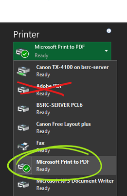

Ok, after some more trial and error, it (perhaps unsurprisingly) seems to have to do with the Adobe Print to PDF driver. I was only using that one because Excel's Save As... (w/ file type set to = PDF) and Save as Adobe PDF were ignoring my page sizes, but the Microsoft PDF driver (below) worked great - links are functional now and it retained my page size & scaling. Hopefully this helps someone!
