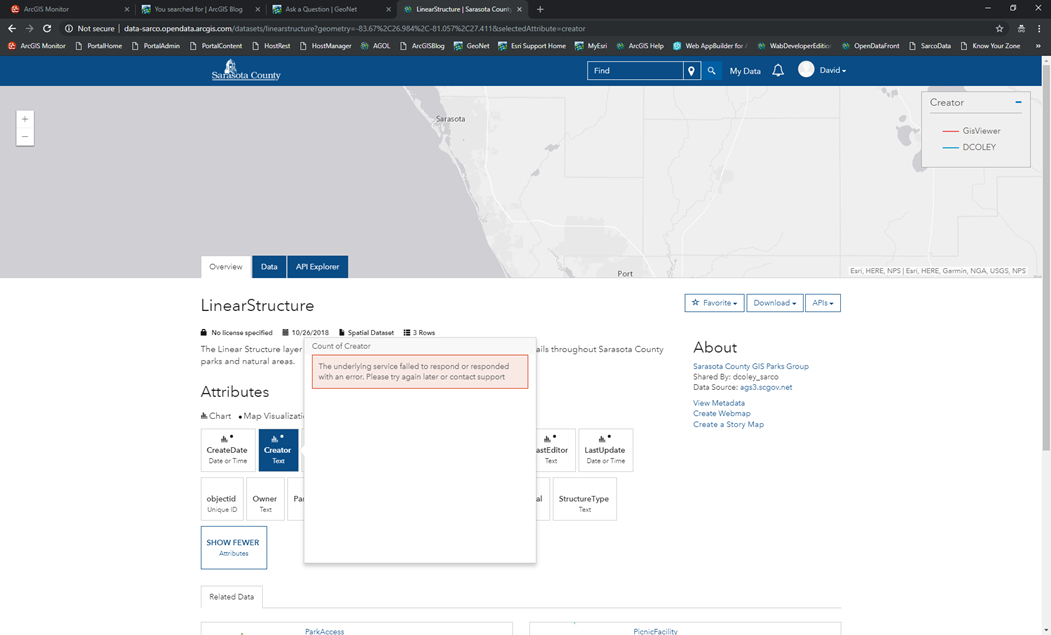

Hello - We use collaboration to push our ArcEnterprise 10.6.1 portal hosted layers to our ArcGIS Online organization and in turn make those layers available to Open Data.
I just noticed in the last week or so that once you are on the Overview tab on your Open Data site, and click an attribute that has charting and/or map visualization enabled (not sure how Open Data even selects which attributes can be charted and/or map visualized) AND a count error is returned:
That in turn is throwing an SEVERE error category (that I get to see in ArcGIS Monitor) for the given hosted feature layer that resides in our Portal:
The submitted field 'comments_COUNT' is not available in the layer '0' of the service 'wFireDeptConnection'.
and so on every time someone anywhere wants to visualize or chart one of the variables that supports that capability.

If this error still persists at the 10.7 upgrade then I will begin a support case.  As it stands now, I'm amazed this hasn't gotten more traction, that no one else out there hasn't seen this error?  Here is an example of what the error looks like on the host site as logged from ArcGIS Monitor:
IDQTimeTimeCodeTypeCount/IntervalUserMachineMethod NameMessage
102/26/2019 5:57 AM02/26/2019 5:45 AM9000SEVERE1SCGGISAP01PW.BCC.SCGOV.LOCALThe submitted field 'facilityid_count' is not available in the layer '0' of the service 'wServiceConnection'.
202/26/2019 5:57 AM02/26/2019 5:46 AM9000SEVERE1SCGGISAP01PW.BCC.SCGOV.LOCALThe submitted field 'watertype_count' is not available in the layer '0' of the service 'wServiceConnection'.
302/26/2019 5:57 AM02/26/2019 5:46 AM9000SEVERE1SCGGISAP01PW.BCC.SCGOV.LOCALThe submitted field 'zonetype_count' is not available in the layer '0' of the service 'CommunityFloodZone'.
402/26/2019 5:57 AM02/26/2019 5:47 AM9000SEVERE1SCGGISAP01PW.BCC.SCGOV.LOCALThe submitted field 'tax_yr_chng_count' is not available in the layer '0' of the service 'Easement'.
502/26/2019 5:57 AM02/26/2019 5:47 AM9000SEVERE1SCGGISAP01PW.BCC.SCGOV.LOCALThe submitted field 'watershedname_count' is not available in the layer '0' of the service 'CommunityFloodZone'.
602/26/2019 5:57 AM02/26/2019 5:48 AM9000SEVERE1SCGGISAP01PW.BCC.SCGOV.LOCALThe submitted field 'servicetype_count' is not available in the layer '0' of the service 'wServiceConnection'.
Usually there is about 200 per day, seemingly random, usually beginning around 4:30 am EST and lasting up until 10 am EST.  There are different layers showing up each day returning a count error.
I can confirm that human interaction with the attribute charting on Open Data does throw the error as I show above, but because there are so many on different layers each day that makes me think it's some type of indexing process with our Open Data site that makes this occur.
