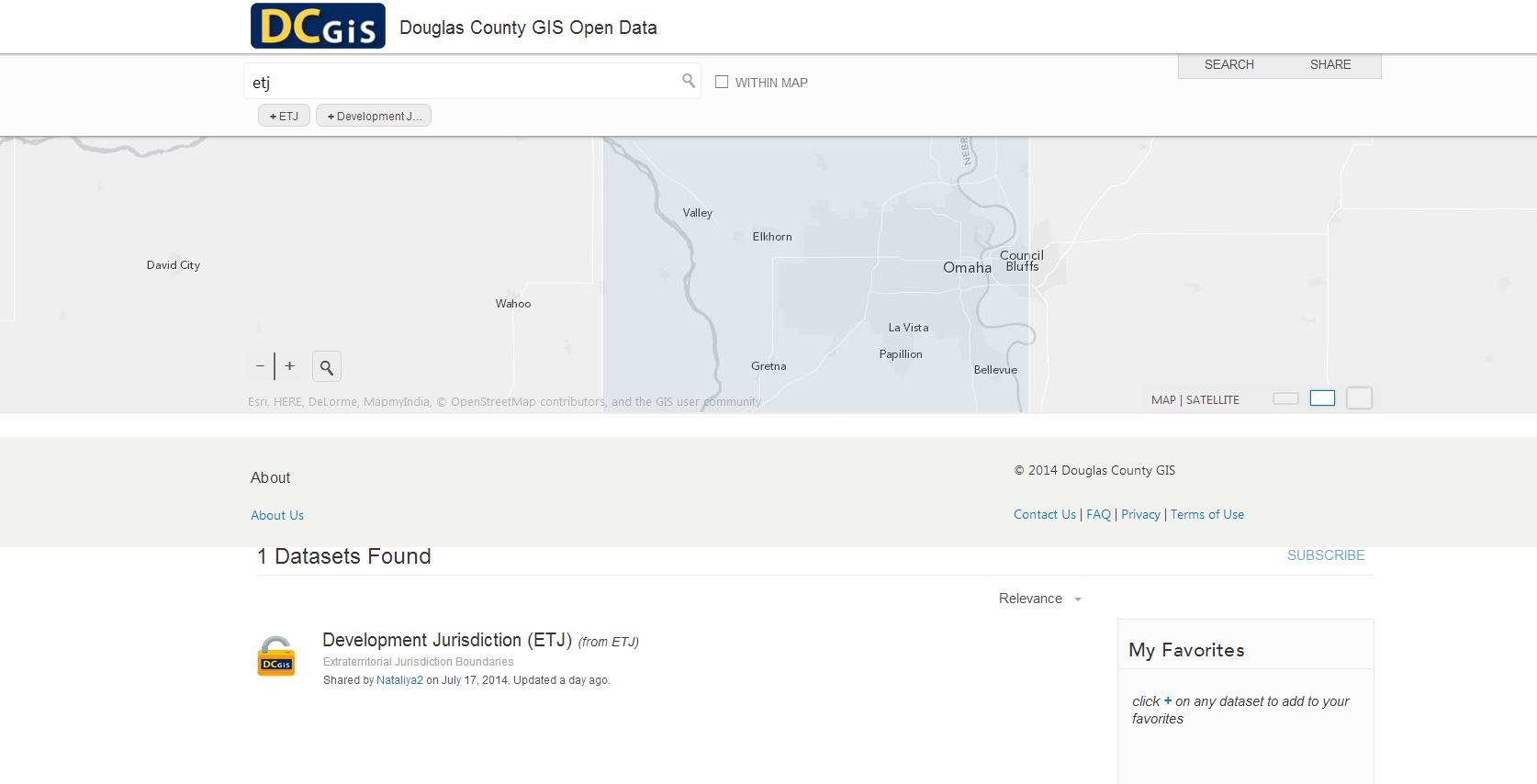

Hi, I am working on our the open data website, and i am having the following issue: When I type information in the search bar and click search - on the result page I get my footer showing right below the map and above all the datasets list. I cannot figure out why this is happening? Would appreciate any suggestions. Thank you.

Courtney reached out to me to see if I could help assist you. When I look at the HTML structure of your site, it looks like the footer <footer id="footer" class="footer"> [footer contents] </footer> is above <div id="slide-me2" class="layout" style="display: none;"></div> in your page. By default, slide-me2 should be above the footer since that particular ID is what displays the search results. Is there any chance these two elements got reordered in your HTML?

Thank you. I see what you are saying. I looked at the page source on my browser and could see where the "footer"  was above the "smice-me2". I added the <div id="slide-me2" class="layout" style="display: none;"></div> to my html.
By doing this my footer container got bigger, and the search results are displayed in the footer container (with footer text staying on the bottom).
